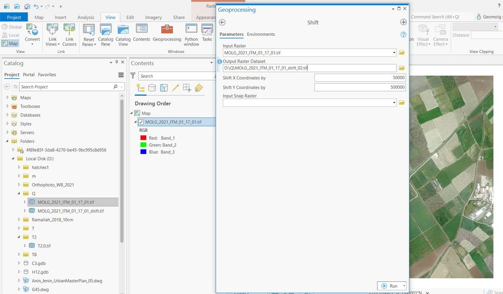

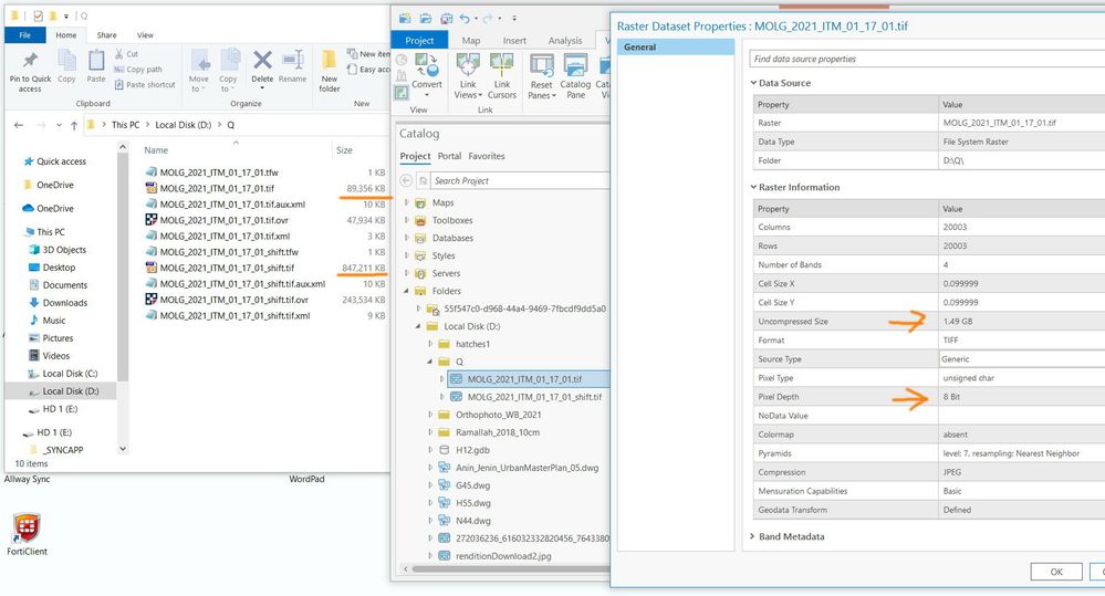

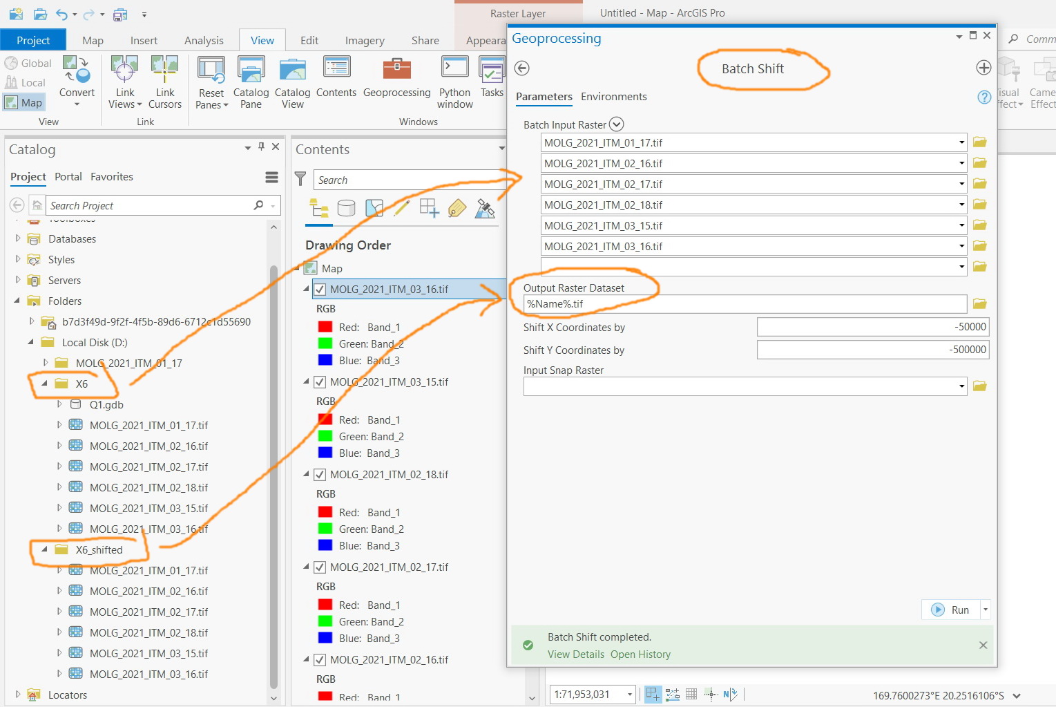

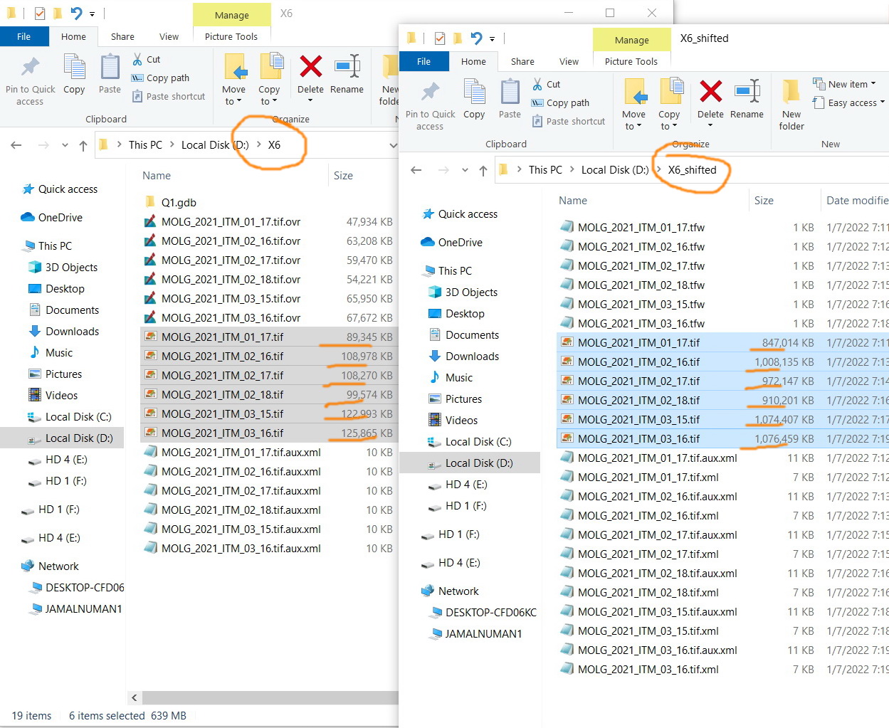

I couldn’t figure out why the size of the shifted imageries (with the batch shift tool) is much bigger than its original.

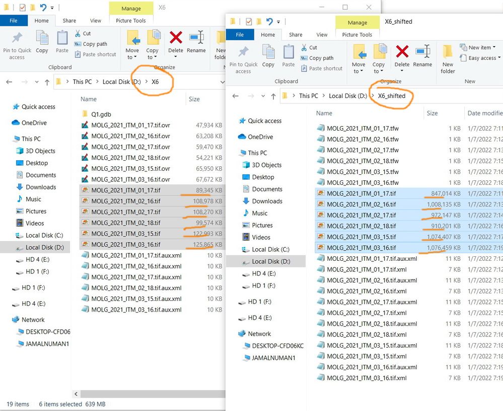

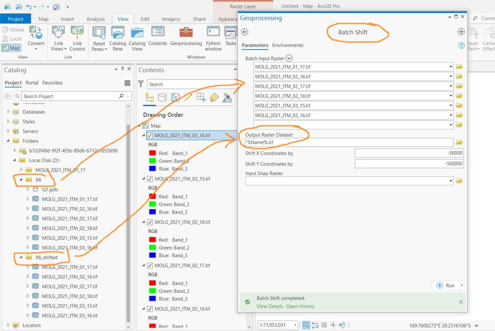

For example, in the screenshot below, the batch shift tool is performed to shift multiple imageries. I compared the size of the original imageries with the shifted and found out that the size is 10 times
What could be the issue here? How to reduce the size of the shifted imageries?

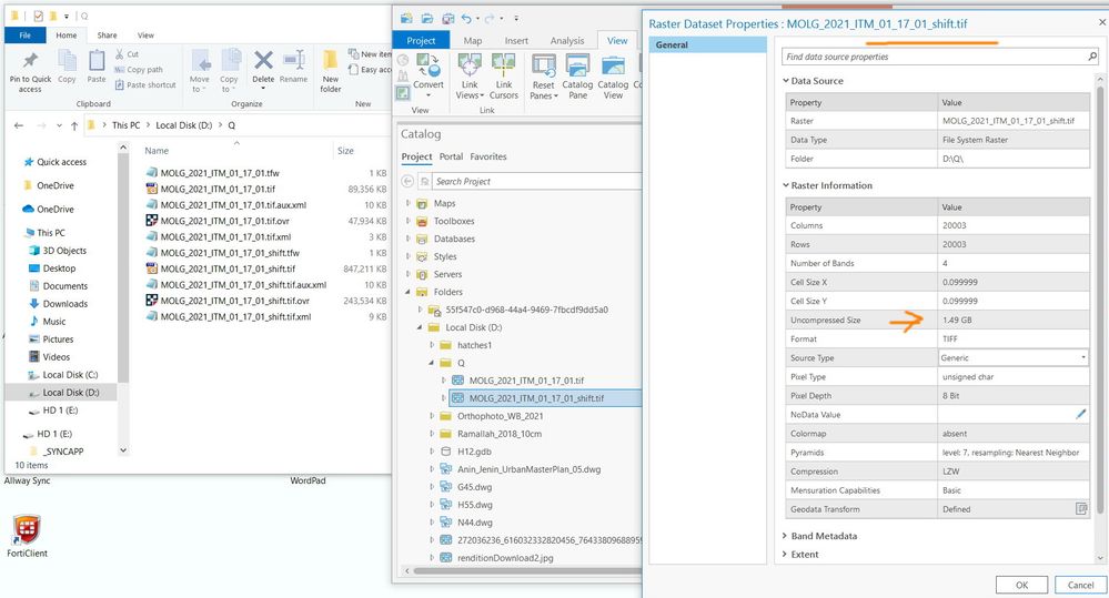

take one of your unshifted images and find its shifted match,
right-click select the properties and see whether there is a difference in compression type under raster properties for both.  Examine the Environments tab for the batch shift tool and see what was set there.  There could be differences in the environments used from the original image and shifted images.

compression... jpeg vs lzw

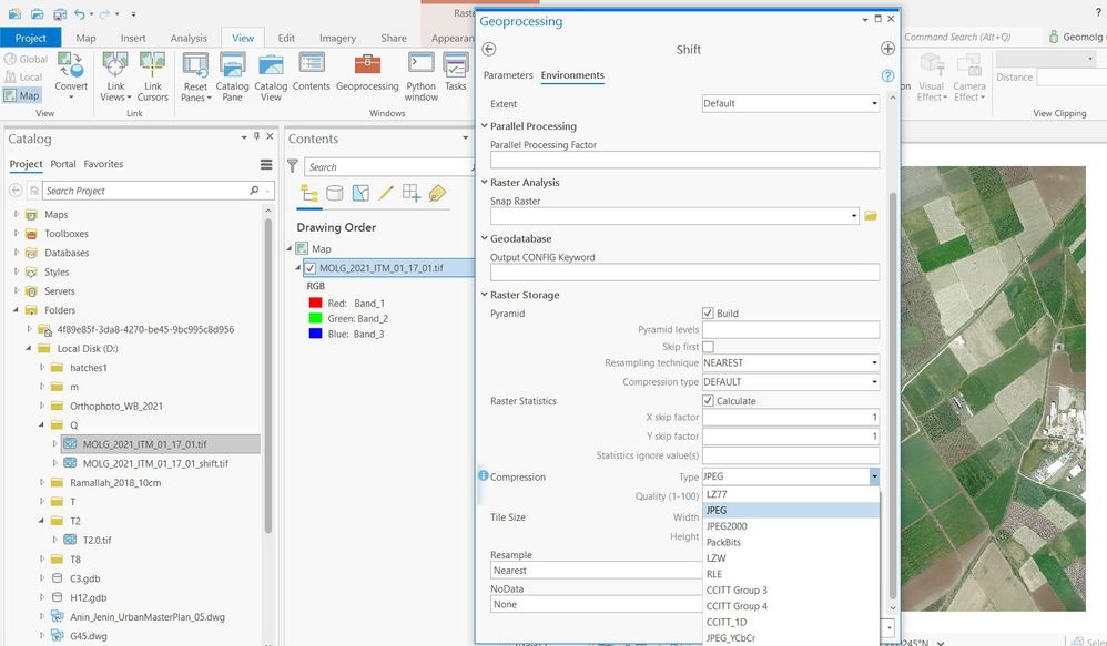

The question is about file size and what is appropriate for your desired file format (*.tiff).k
If you want a file type that doesn't change its size when you want to shift it, use one that doesn't use any internal spatial referencing but relays on a text based world file instead.... for example *.tifw .... you can just do the "shift" with the world file IF there is no coordinate information retained in the *.tif file itself
