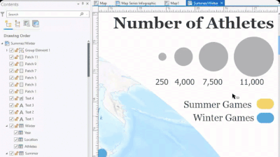

Today's tip comes to us from @AubriOtis through a tweet.
In 2.6 or later when working with grouped elements on a layout or map graphic layer, click once to select the group and twice to select the item in the group.

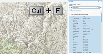

Ctrl+F it!
New trick this afternoon.  When working in a map or scene and you need to find something, use Ctrl+F to open the Locate pane.

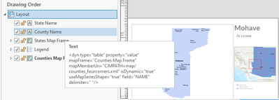

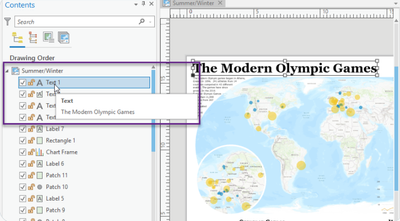

Here is another great tip shared by @AubriOtis
https://twitter.com/AubriGIS/status/1412875705843552257?s=09
Hover over a Text element in the layout's Contents pane to display the full text.
This also works to show the dynamic text in place for that element.
Sub-tip: even with this cool trick, it is still good practice to give your text elements more descriptive names in the Contents pane!
