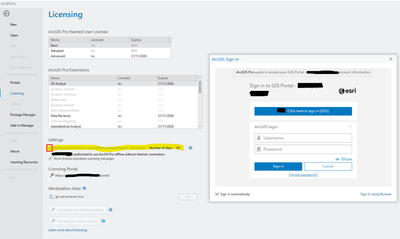

Please follow the instructions
Python in ArcGIS Pro—ArcGIS Pro | Documentation
Authorize Python outside the application
If you run Python scripts that use ArcGIS Pro functionality outside of the ArcGIS Pro application, such as a Python IDE, from a command prompt, or running scripts through scheduled tasks, one of the following conditions must be met:
1.Sign me in automatically is checked when signing in to ArcGIS Pro.
2.ArcGIS Pro is currently open.
3.ArcGIS Pro has been authorized to work offline.
4.ArcGIS Pro is configured with a Concurrent Use license and at least one license is available on the ArcGIS License Manager.

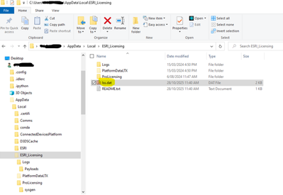

I'm not sure if this is how the licensing works but it seems you can check if a license file is present for the user signed into ArcGIS Pro.
If you look in hidden the folder C:\Users\<your username>\AppData\Local\ESRI_Licensing there is a file called  lss.dat. If this file is present then you will be licensed for arcpy. If it's not there you will not be. The log file in logs tells you when you have created the lss.dat file and what you did to create it.
As mentioned above by Shovon there a few criteria that you could meet to create this file. Unfortunately, if your user is running a scheduled task and isn't logged in the options to be signed in or have ArcGIS Pro open are out, which leaves the bottom two. Unfortunately, as erinheinrich mentioned concurrent use license doesn't work as expected either so that leaves 'Authorising ArcGIS Pro to work offline without an internet connection
