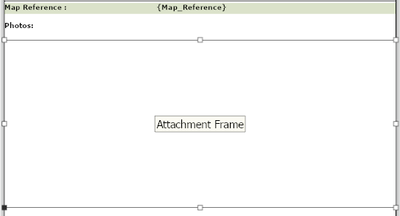

I have created a details report to do this with a feature reference (from an attribute) and an attachment frame that is set as a 2x2 grid (ideally we would like this to auto expand based on how many photos there are, but that's a separate issue).

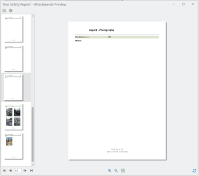

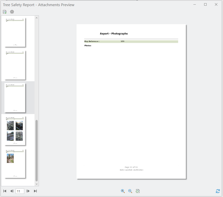

This is working to a degree, but is producing a page (or record) for every feature, regardless of whether there are any attachments. So if there are 10 features and only 2 of them have attachments, it's generating a 10 page report with mostly empty pages, which is not good!
