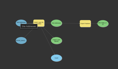

I have created a model in model builder that selects a dataset based on location and then should overwrite an existing data set with the selected features. When I run the model, instead of overwriting with the new features it creates an empty dataset. Any ideas on what the issue is?

This got the model to run correctly. Previously I was trying to use the "create feature class" tool. Changing it to "export features" produced the desired result.

Can you export your model as a graphic and attach it to the thread so we can see what GP tools you're using?
