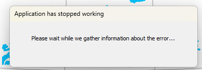

After I updated to 3.4, I've been getting frequent crashes when opening an existing project file for an operation, I'm not sure which operation is causing the crash, but the operation before each crash is different. It has crashed three times in the last hour and I have sent reports for all of them. Does anyone know of a potential cause of the crashes for me to avoid?

Good news, I found the reason for the crashes.
I used the newest function of "work with legend patches", and I converted a polygon to a graphic then I saved it as a legend patch. And I used this new patch for my legend and save projects, but an unknown reason trigger this crash. so I had to use another computer which version is 3.3 to remove my features in the contents and save the project. when i open the project on my PC again, it doesn't crash again.
So, the reason for the crash is the new function----work with legend patches. Please fix it ASAP.
