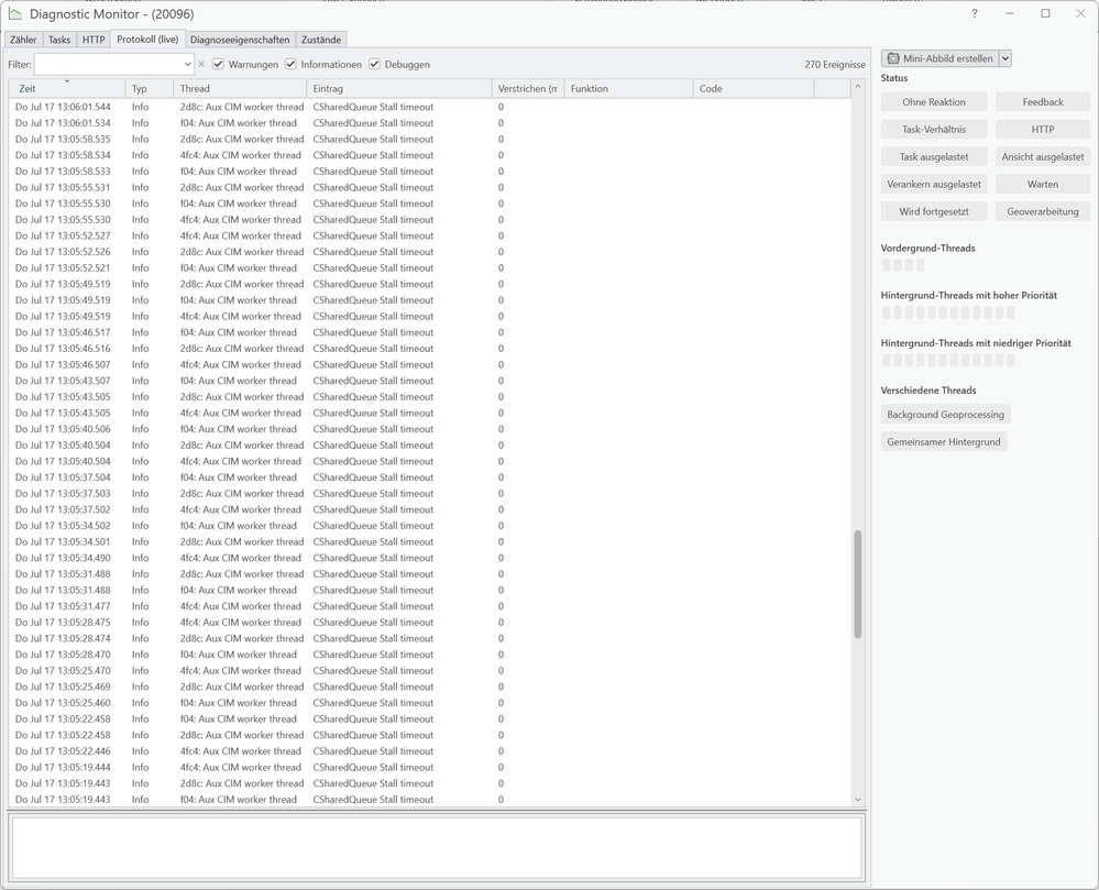

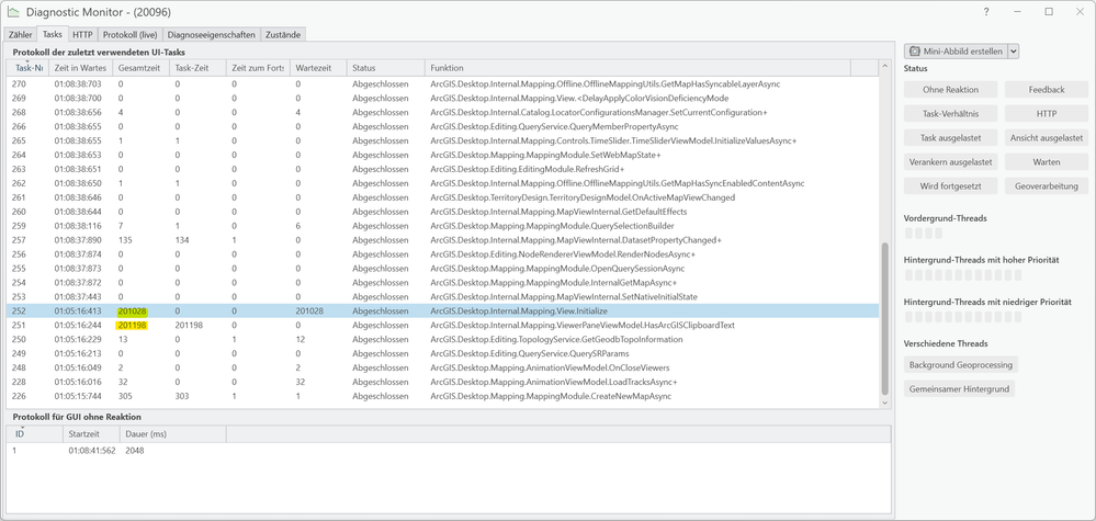

We also noticed performance issues with ArcGIS Pro Versions >= 3.3. I tested a fresh computer-wide 3.5.2 installation. Adding a new map without a background map sometimes takes over 3 minutes! This is unacceptable. Just like @ThomasMelton_ARDOT , I also observed a lot of Aux CIM worker threads in the Diagnostic Log where giving a CSharedQueue stall timeouts. At first I suspected OneDrive, but the problem cannot always be reproduced.

CSharedQueue Stall... the new PC LOAD LETTER. Any updates?

Also looking for an update, we just moved to pro3.3 on Azure and have been having performance issues. This seems to appear a lot in the log.

We have also Pro 3.5.2 and exactly the same messages in  the logging:  CSharedQueue stall timeouts . There is a hang situation after several open Attribute Table's of feature classes in an Enterprise Geodatabase (ArcSDE 11.3) . The timeouts keep going. It seems an inifinite loop. Do you still have these problems? Is there any solution? It seems to me a bug.
