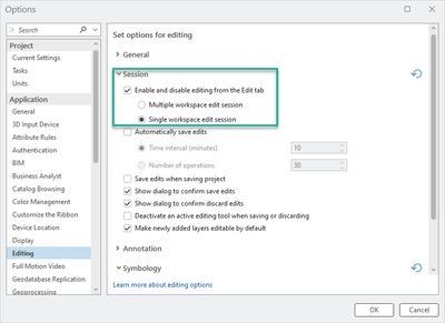

@BryanMc what option do you have checked in the Options page for 'Enable and disable editing from the Edit tab'?
For your workflow, I would expect the issue you are reporting if you have 'Single workspace edit session' checked since your feature class and table are in different workspaces.
BryanMc
Thank you @JMutunga ,
It was set to Single Workspace. I switched it and it confirm it works. Although no thanks to the error message.

I was just having the same issue. 'Single workspace edit session' was the problem. Changing to 'Multiple WES' did the trick, but in an non-versioned EntDB environment, quite risky as edits are immediately committed without the chance of reverting. 😬

@DenisLalonde Single workspace edit session was mainly introduced to support discarding edits in a non-versioned workspace to avert the risk you mention. For your case, I hope changing to multiple edit session does not interrupt your workflow too much.
