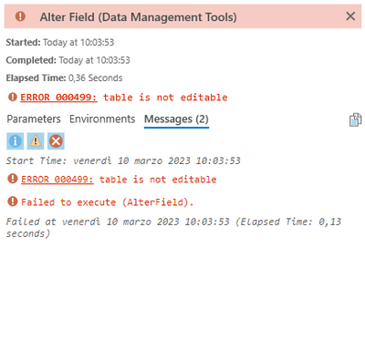

Hi,
With ArcGIS Pro 3.1, I'm not able to alter field aliases of registered views anymore (sde version: 10.9.0, Oracle database).
Is that a known issue? At version 3.0 it works perfectly.
This problem is seriously affecting our productivity and is preventing us from upgrading to ArcGIS Pro latest version.
Thank you for any help you can offer.
PaulDziemiela2
Hi Tram,
I found the same bug.  Has anyone filed a report with Esri on the matter?
