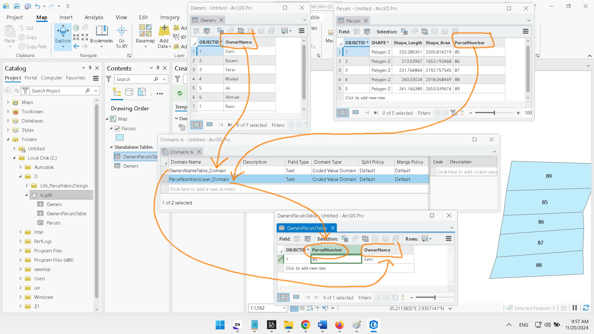

For example, in the screenshot below, I want to create a domain that reads its values from a field in an existing table. In this case, the “OwnersNameTable_Domain” needs to read from the “Owner” field in the "Owners" table.
How can this be performed?

The issue with this approach is that the domain is not dynamic, it needs to be updated each time the owners or the parcels table are updated.
