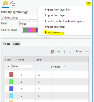

Hi, Vincent.
How did you export to a .clr in ArcGIS Pro?
Alec
by
For anyone looking

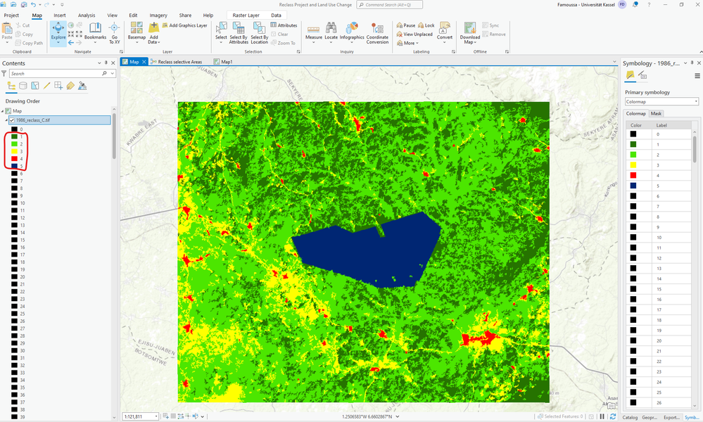

FamoussaDEMBELE
New Contributor
Hi,
I have a single band raster with a color classification I applied a colormap using .clr file (which had 5 predefined classes from 1 to 5). Now after adding the colormap, I am getting other unwanted classes which are not of my interest as seen below. How do I remove those classes that are not represented on my raster image without changing the colormap settings?Class needed for the colormap.png
Thanks

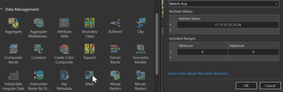

VincentLaunstorfer
Hi,
In the Imagery tab, I used the Raster Functions -> Data Management -> Mask in order to 'mask' unwanted pixels, as shown below. Although, you seem to have lots of unwanted pixel in your example. I would recommend to reclass your raster beforehand to 'group' all unwanted pixels together.
Hope this help
FamoussaDEMBELE
New Contributor
Hello,
Thank you very much for your feedback.
I tried to reclassify all the unwanted classes to 1 class. However when I export the reclassified data (map) the colormap and import it again, it comes back with the unwanted classes.
