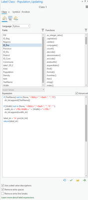

Not sure why you are still getting an error as the code works for me, I suspect you don't have the correct indentation?
I spoofed up your fields in a dataset I have and as you can see it works:
