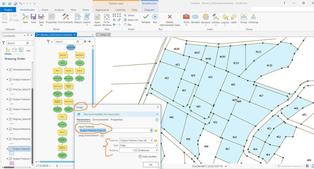

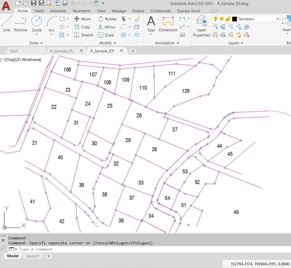

I couldn’t figure out why “extend” tool fails to extend particular lines.
What could be the issue here?
Sample data is attached

Could you try:
  1. Collapse circles to point features
  2. Use the Snap tool against the Lines, setting the Snap Enviroment to "END"
- Josh Carlson
Kendall County GIS
JamalNUMAN
Legendary Contributor
Many thanks jCarlson for he help. It works like a charm
