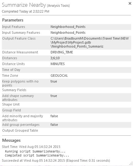

We are working on some travel time studies, and realized that the Summarize Nearby tool would suit our needs. Pre-update (when we just had Pro 1.0) everything worked perfectly. We would open the tool, set our parameters, click run, and the results would pop up right on the map.

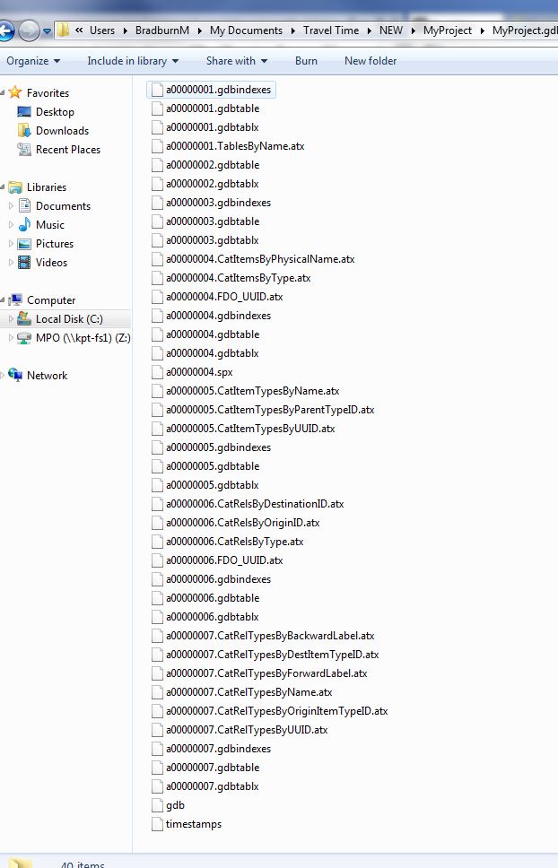

Now that Pro has updated to 1.1, we have no results. We set the parameters just the same, click run, and Pro reports that it was successful and tells us where the new file is supposed to be, but nothing comes up on the map. I figured it was just a little error, but when I followed the path to the folder and geodatabase where the new feature should have been saved, I found nothing. It's like Pro thinks that it is correctly running the command and providing results, but it's not.

Here is where it's showing us that it ran and was successful:
Here's the geodatabse that it is supposedly being added to, but it's not there:
