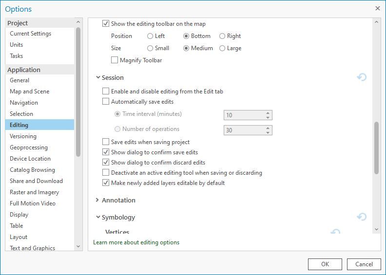

Teth - sorry to hear you've been losing a lot of edits over time.  Annotation is a feature class stored in a geodatabase and technically stored in a polygon feature class.  Like any vector editing, you have to save your edits to commit those changes to the geodatabase.  This was the same workflow as in ArcMap through the editing toolbar.  There are some settings you can save in ArcGIS Pro options to prevent losing edits in the future.  If you go the Project tab-Options and click Editing in the application group, under Session there are some great options to enable to prevent data loss.  Click the "Save edits when saving the project" or "automatically save edits (every time period or number of operations)"  Hope this helps!
