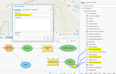

I hope this helps.
time.strftime("%y%m%d")

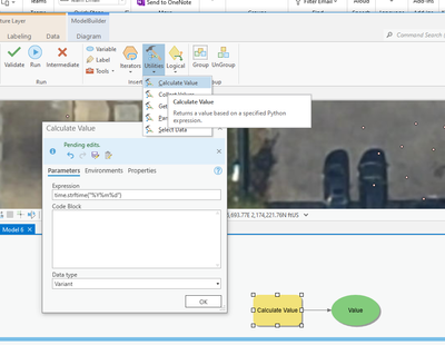

For some reason, I can't find the Calculate Value tool. Also, I need the year in YYYY (2022)
KimberlyGarbade
You can find it under the Utilities menu in the ModelBuilder tab.  Try using a capital Y instead of the lower case one I sent earlier.
time.strftime("%Y%m%d")

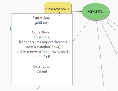

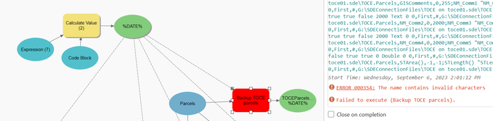

Can I bring this thread back to life? This is how I went about solving the same issue, but my model throws an error code of "Invalid Characters" whenever I try to name an export with the inline variable that I created...
This is my code block for that Calculate Value field ...
