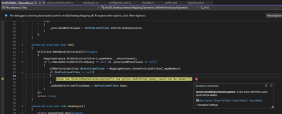

This pops up in Visual Studio when the SetDefintionQuery is called:
Kevin_Andras
I just ran the exact same code on a 3.4 installation and I did not get this error.

Looks like if I try to use the code to set the definition query to null when it is already null, I will get this error.  I can work around that.
mikeharol
I had a similar problem.  In my case, I was setting a definition query to an empty string when there was no definition query to set.  Not a problem in 3.4.  What I ended up doing was checking to see if it was empty first.
if (lyr.DefinitionQuery.Length > 0)
lyr.SetDefinitionQuery(string.Empty);
