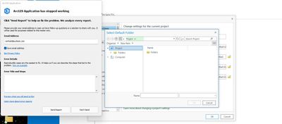

Anytime the dialog box comes up to interact with PC filesystem.  I decided to capture a screenshot.  The suggested workaround did work, so I went to look at settings if default paths were part of it.  As soon as I hit the folder icon, bang.

Just did the 'open other project' again and submitted the error report.  I did not see an error number

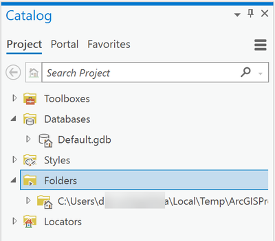

blank template
went to catalog, clicked on folders and there was a default one based on my profile on my local machine
Did you get this far? is there any default folder?

yes, but when I right-click on Folders, select Add Folder Connection, the filesystem dialog pops up, and error reporting.
