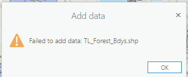

Hello
I get the following error when i try to add a shp file to a map
I get this error only when i try to load the shp file from a network drive.  If i copy the files to my PC I can add the map.

Figured it out.
Turns out that even though I could see the file on the network drive it hadn't sycncronised correctly and i hadn't noticed.
The files are uploaded by field users in other parts of the country and i add them to the map.  Dragging the shp onto the map or going the long way and clicking add data etc was not syncing the file on the drive.
I have to sync all three shp files for it to work

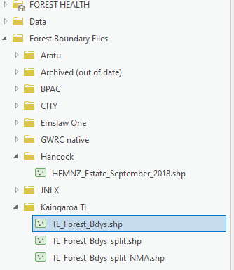

BrentRogan
These are the files I can see in the folder.  As far as I know they are the correct files.  I check some data from last year and its the same three file types in the folder back when it worked from the network drive.  I even tried to copy a shp file from the network drive from last year and got the error message.
If I copy the three files to the local drive it works fine

I wonder if the shapefiles on the network drive are corrupt for some reason as it seems when you make a copy of the shapefile local on disk, it works as expected.  I'd recommend examining some of the workflows here to determine if you have corrupt shapefiles.  Then repeat the workflows in your original message.  Does the error persist?
