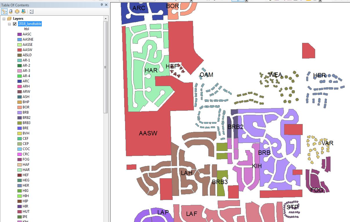

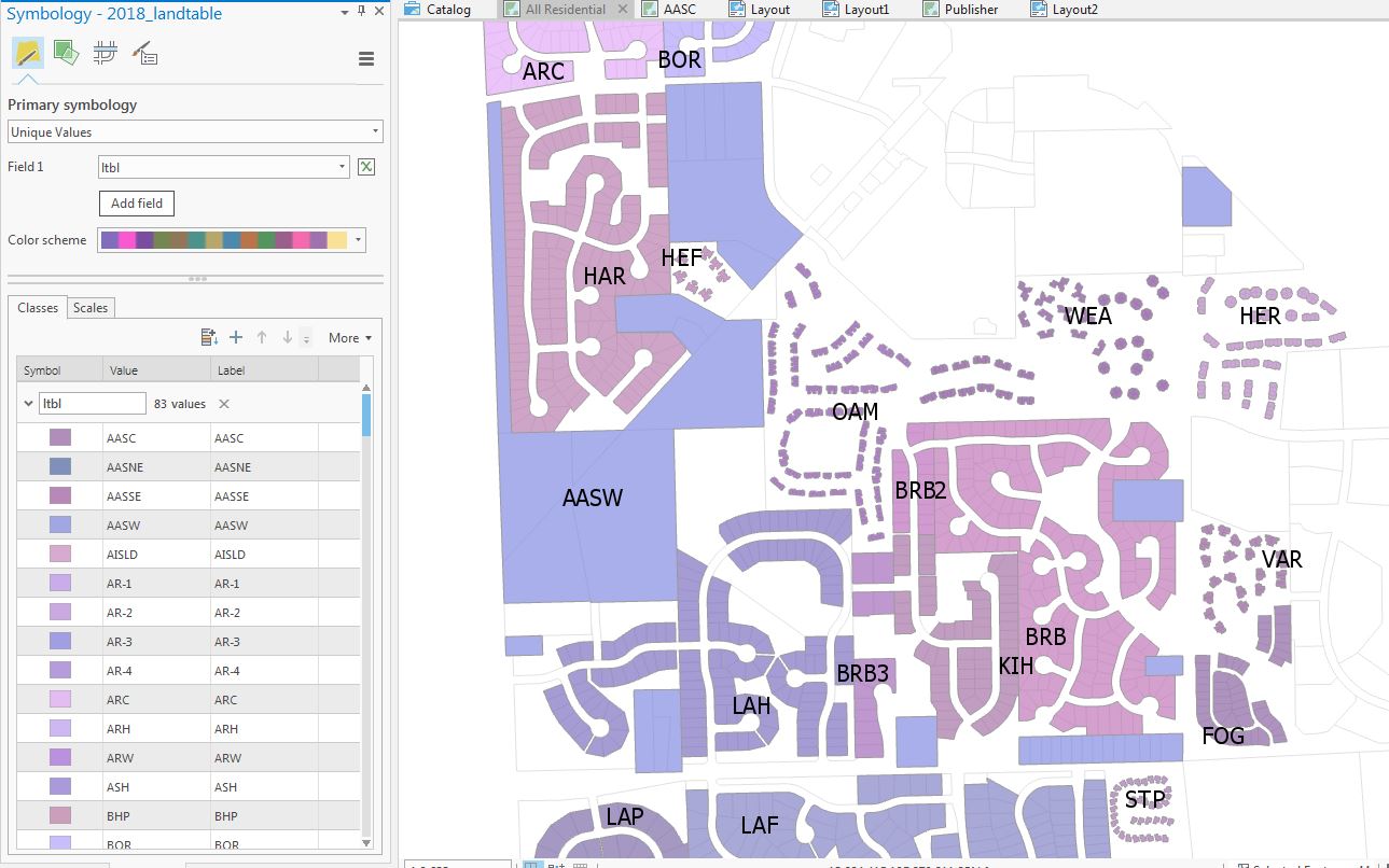

I am trying to replicate the automated random color symbology in ArcMap for tax neighborhoods but ArcPro tends to group unique values together (or use only about 6 different colors) defeating the point of unique value symbolization... is there a work around?  See screen shots for exact example
ArcMap:
ArcMap unique Random Symbology
ArcPro
ArcPRO unique Random Symbology

Why don't you add a second field to the symbology classification. You could probably use an existing field, just make sure it isn't one that has the same pattern as your main field... that might mess with the apparent sequential pattern

It seem like Pro really goes out of its way to make sure that features that are geographically close together get the same or almost the same colors. I even tried generating random values for the field that I am classifying by to see if that helps. Does not help.

Thomas - from what I'm reading of "What's New in 2.3 ArcGIS Pro", there will be 24 new random color schemes from ArcMap added to ArcGIS Colors to improve upon the random symbology issues.  I believe AGP 2.3 is listed for a Q1 2019 release time frame.

Have you upgraded to ArcGIS Pro 2.3 yet?  The new update has more color schemes to choose from. I read somewhere that AGP 2.3 now displays data similar to ArcMap in with default symbologies and default colors.  Haven't checked the Random Color Scheme yet.
SeanSummers_CC
I have upgraded to 2.3 and after using for a few days, I am much happier with the random color patterns.  It appears to be working as expected now.  Thank you ESRI for looking into this and fixing it.
