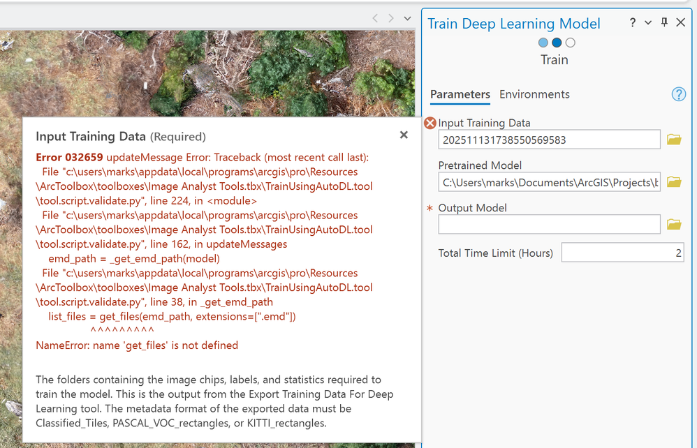

3.6 Train Deep Learning Model won't accept Export for Training Data for Deep Learning training chips
281
3 weeks ago
MarkSchweder
I just upgraded to 3.6 and now this nonsense starts. I've tried several alternatives without success. Any suggestions?
Thanks, Mark

Did you install the deep learning framework for 3.6?
Esri/deep-learning-frameworks: Installation support for Deep Learning Frameworks for the ArcGIS Syst...
Note:
Each version of ArcGIS Pro requires specific versions of deep learning libraries. When you upgrade ArcGIS Pro, you need to install the deep learning libraries that correspond to that version of ArcGIS Pro. For the list of libraries required at each version, see
Deep learning frequently asked questions—ArcGIS Pro | Documentation

MarkSchweder
I'm doing it right now. Thanks!
MarkSchweder
I've tried exporting the metadata as a Classified Tiles without success.
PASCAL_VOC_rectangles is not a provided option when exporting the metadata format and the alternative: PASCAL Visual Object Classes doesn't work!
KITTI_rectangles is not a provided option when exporting the metadata format and the alternative: KITTI Labels doesn't work!
