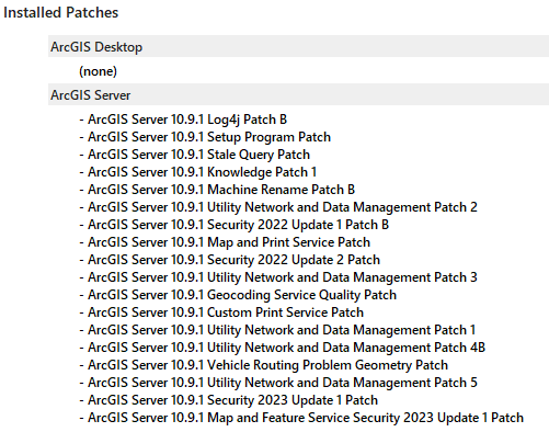

I did look into your case and it appears that you might be hitting an issue that was already patched.  Can you have the following patch applied to your server?  https://support.esri.com/en-us/patches-updates/2022/arcgis-server-geocoding-service-quality-patch-80...
Mike_Quetel
I believe we are patched for this.  Just pulled from the server.
