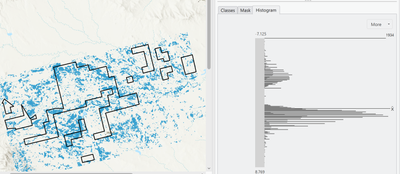

In the example I imported symbology from another layers based on latitude onto the column longitude. It is completely out of range, but normally I would want to keep the class limits. I calculated the statistics for the lon column in the table and then chose an upper value which definitely lies in the range of Lon. I added out of range symbols, otherwise the map would be simply white. The points would not be selectable. Choosing to update the range during support would change all class limits when anautomatic classification was chosen in the original layer and not update when "maual interval" is chosen.In the example I imported symbology from another layers based on latitude on the column longitude. It is completely out of range, but normally I would want to keep the class limits. I calculated the statistics for the lon column in the table and then chose an upper value which definitely lies in the range of Lon. I added out of range symbols, otherwise the map would be simply white. The points would not be selectable.
15 Comments
CordulaGöke
I agree with @MaxMolello , @CraigWilliams  answer actually works, but it is not obvious, that the values in the histogram are editable . Great, problem solved, I would just wish ArcGIS Pro was more intuitive. As histogram, I would expect some connection to the data distribution, in reality, it shows simply the class size graphically.

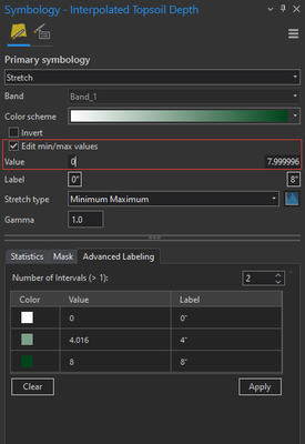

I was able to adjust the Min and Max values of the Raster Stretch Symbology by using the Minimum Maximum Stretch type:

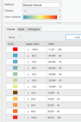

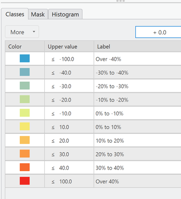

DougBrowning
I am stuck trying to do this script.  If the range is really small like =.0003 to .00003 it will completely ignore my custom breaks and use a totally made up scale.  If the range is medium the breaks take but then the map gets all one color - the min value color.  This is totally wrong and users get the wrong idea.  In my case I have -100 to 100 for percent's.  If the range is -7 to 8 then I get ALL of the map getting the color of -40.  These maps are generated in a GP tool on the fly and need them all to have the same symbology.
Totally stuck.  Any ideas.

 If I save out the map I got the correct range but colors are wrong.
Why is it getting blue?
Also really wish we could set an exact range.  This upper bound thing is so confusing esp with negative numbers.  Plus what I want to leave certain values out?  Let me set a upper and lower and call it a day please.
Then if I add a interval in Pro it still lumps -7 to -100 at the top.  This seems way wrong right?
