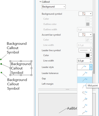

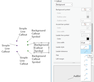

If you use the Simple line callout style, the snap point will be one of the 4 corners or 4 midpoints of the annotation feature's bounding box. Moving the anno changes the snap point to the one nearest the feature which isn't always desirable for reasons you've described.
While this isn't exactly what you're asking for, in some situations it might help to use the Background callout instead of the Simple line callout because it will give you some more leader line options. In particular, you could change the Leader style between Base and Mid point styles. The Base style behaves similar to the Simple line style in that it snaps to the nearest corner or midpoint of the label.
The Mid point style only snaps to the mid points of each line so you could change the Leader style of an annotation feature you want to force to use a midpoint leader origin.
Read more about the various callout symbol properties in the Text symbol properties documentation

MErikReedAugusta
@JesseWickizer That midpoint option is exactly what I was looking for about a week ago, but couldn't find!
Though on the topic of the original idea, I feel like there's maybe still some room for improvement in ArcPro.  I ended up converting all of my labels to Graphics because I needed positioning options that the software wasn't able to accomodate, and discovered to my delight that I could manually reposition the anchor of the leader line inside the polygons I was targeting.  But I could not manually reposition the other anchor, where the line attached to the label, itself.
Even just opening up access to both anchors would provide all manner of options beyond just the midpoint, so we can fine tune to our hearts' content without having to pull it into another program like Illustrator.

@JesseWickizer
Hi, thank you for the thread. My issue is that using a background callout and the simple line style it only ever snaps to corners. The midpoint style only ever snaps to the left or right midpoint. Please tell me how (or even if) I can make the leader line snaps to the closest line midpoint of my callout box.
And I agree with @MErikReedAugusta - ideally I want to manually position the callout box end of the leader line wherever I choose.

mzhang
by
@JesseWickizer as a consolation until setting leader line anchor points are a thing, could the Mid Point style be updated so that it includes the midpoints on the top and bottom of the text box too? 🙂 Currently it's only on the left and right, and lately I've been frustrated by the inability to make leader lines snap to top center/bottom center.
