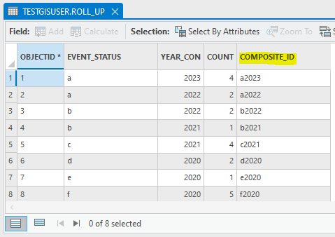

I have a ROLL_UP table that has a COMPOSITE_ID field.

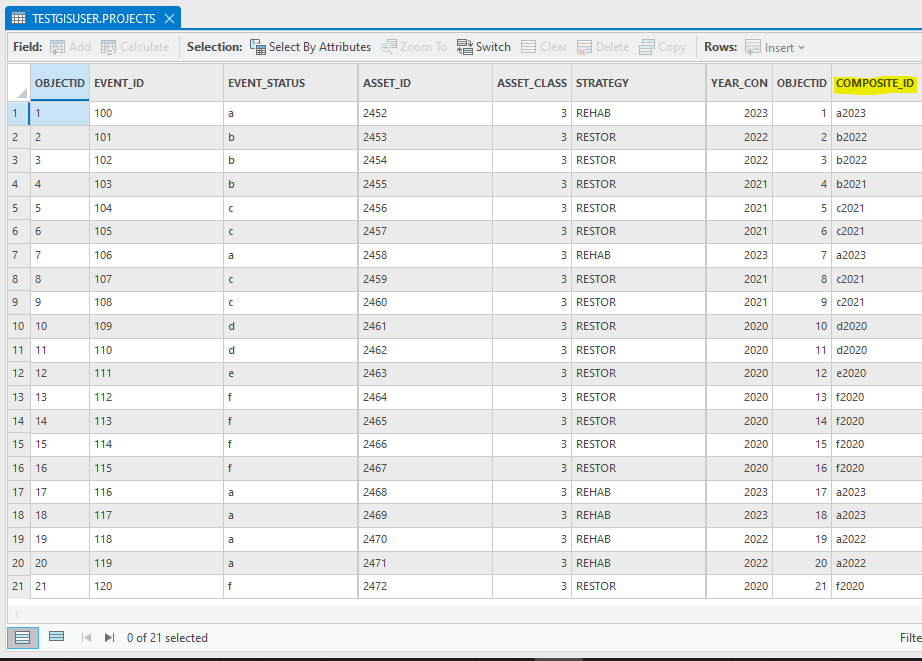

And I have a PROJECTS table:
I want to do a relate from the ROLL_UP table to the PROJECTS table via the COMPOSITE_ID field.
Since PROJECTS doesn't have a COMPOSITE_ID field, I need to create one by concatenating EVENT_STATUS and YEAR_CON.

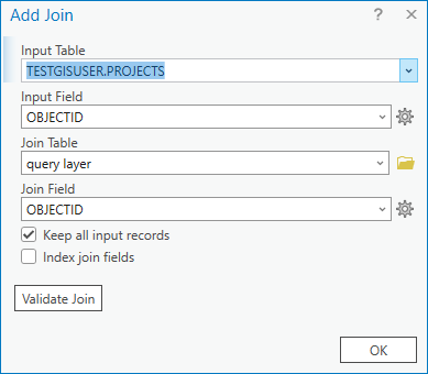

  • So instead, I'll create a query layer and join from the PROJECTS table to the query layer.

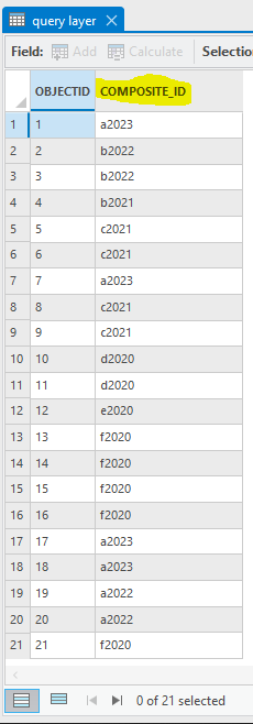

Create a query layer on PROJECTS:
select
    objectid,
    event_status||year_con as composite_id
from
    projects
Join from PROJECTS to the query layer via the common OBJECITD fields.
Now, I have a calculated COMPOSITE_ID field in PROJECTS.

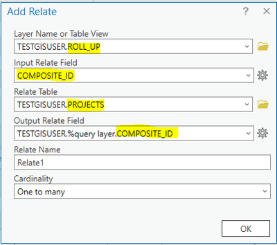

I want to do a relate from the ROLLUP table to the PROJECTS table (and the query layer) — using the common COMPOSITE_ID fields.

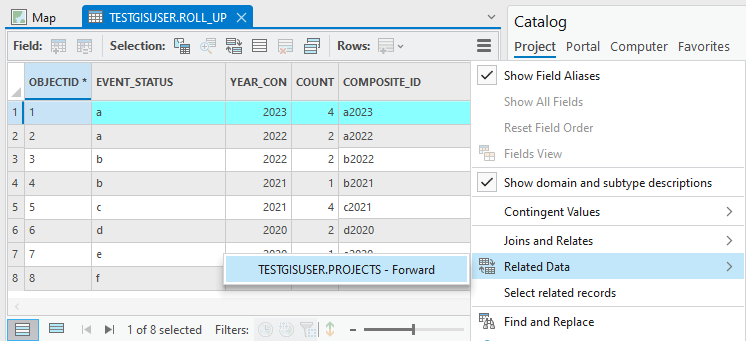

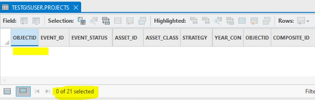

I can create the relate without errors.
However, the relate doesn't work as expected. If I select a record in ROLL_UP and use Related Data to select the related records in PROJECTS, then no related records in PROJECTS get selected.
Whereas, I don't have that problem if I export PROJECTS (and the joined query layer field) to a static table called PROJECTS_STATIC_EXPORT. And then do the relate from ROLL_UP to PROJECTS_STATIC_EXPORT. The relate works without issue, proving that the logic is sound.

I think I figured it out. The problem seems to be when the query layer has spaces in the name. If I create a query layer with no spaces in the name, the relate works as expected.
  • "query layer" doesn't work.
  • "query_layer" works.
Video:
(view in My Videos)
Esri Case #03543479 - Relate from table to table joined to query layer
BUG-000165217 - When a relate exists between a table and a query layer with a composite key joined to another table, related records are not displayed if the query layer name contains a space.
I figured it out by testing a database view instead of a query layer. I didn't have the issue with the view since views don't allow spaces in the name. So, from there, I determined that the space in the query layer name was the issue.
