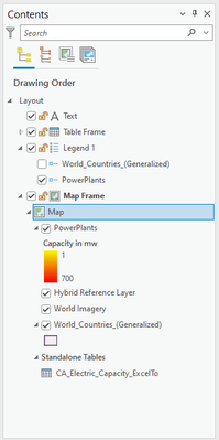

There is no way currently to tell assistive technology what order it should read through items in a PDF layout. For example, I have a PDF that reads the text from a text box at the bottom of my layout before reading the title of the map or the alt text for the map. It would be lovely to have the option to set the reading order without having to modify the document in Acrobat Pro.

This is kind of available. Right now the reading order for accessible PDFs is the same reading order as the items are listed in the Contents Pane for the layout. You can reorder the items there to change how they are read in the PDF. However, that order is also the drawing order of those items, so that may limit how you can order items while still getting the desired layout look.
With this in mind, can you clarify more on how you would like this to work for your workflows?

This is good to know! I just tried it and it worked, so I will send a revised copy to our webmaster to upload.

Reordering the drawing order works in this case. It seems possible to me that this could cause an issue for someone who needed to stack items in their layout, so perhaps it would still be a nice enhancement to have a parameter exposed in the element pane for you to set the reading order? I suppose that could get irritating if there is a lot of text, so maybe a little menu that you could drag and drop the order independently of the drawing order.

I would also like to choose which accessibility tag is applied to each element. I would like to tag certain elements as Headings, as Captions, and so on. That would be really nice.
I have exported a map layout to PDF, and opened the reading order in Acrobat, and noticed that the reading order seems to be in reverse order from the Contents pane-- that is, the bottom item in my contents pane is the first in the reading order. Is that the intended way this works, @AubriOtis ?
