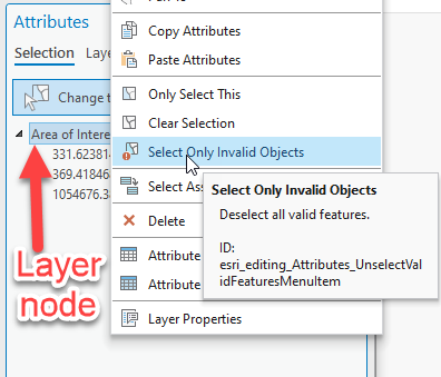

Try this:
  1. From the menu you are on, click 'Select All' to select all features in the layer.
  2. From the Attributes pane, right click on that layer's 'node' in the selection tree.
  3. Choose 'Select Only Invalid Objects'  (in 2.6 this may have said 'Select Only Invalid Features'). This command will remove the features with valid attributes from the selection and leave only the features with invalid attributes selected.Scott_Harris_0-1656082474937.png
  4. From there, you can correct these individually on the feature node, or in bulk if you have the layer node highlighted when updating attributes.
  5. Once you fix a few, run the command again to remove the features with valid attributes from the selection.
Bud
@Scott_Harris Thanks. As you might have guessed, I was looking at the Attributes Table (incorrect), not the Attributes Pane (correct).
For what it's worth, that technique worked fine on a feature class, but I couldn't get it to work for a non-spatial table. I'm not sure why. I deliberately entered an invalid domain value (via the field calculator), but the "Select Only Invalid Objects" functionality didn't select that record (or any other invalid domain records).
Does it work for you when used on a non-spatial table in a newer version of Pro?
