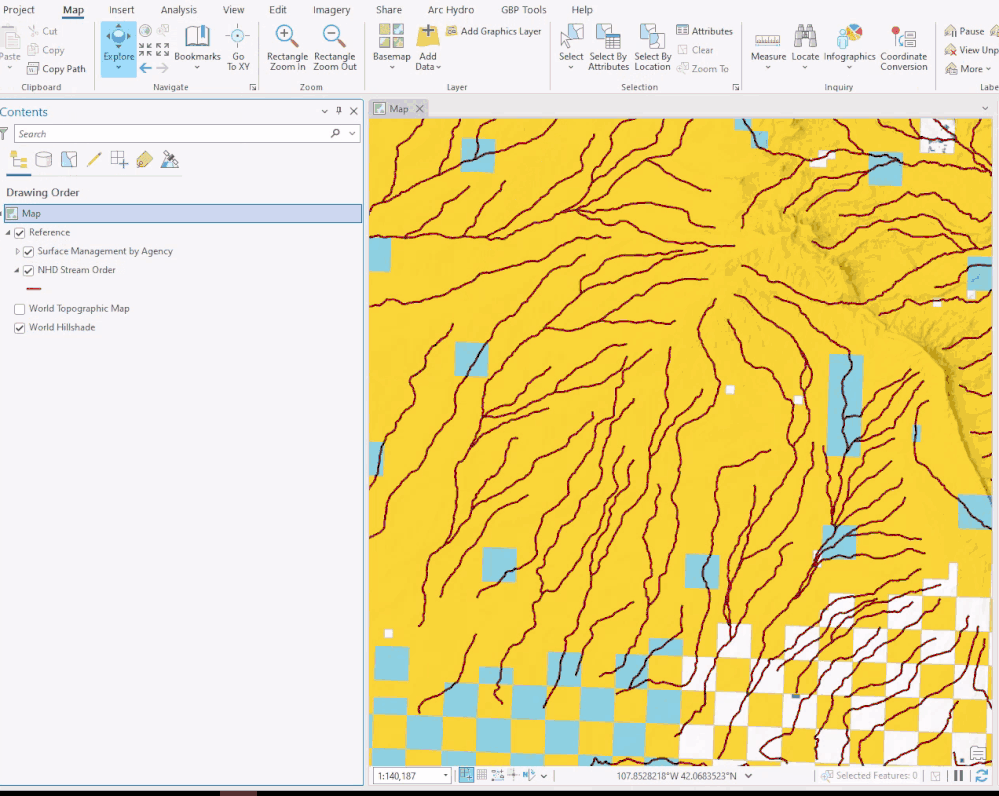

This has been bothering me for ages but today I noticed the behaviour in the second gif and reached my breaking point.
Pause Drawing needs to PAUSE. DRAWING.
Not "change the display when you turn off a layer":
Not "Completely finish rendering (?????????) what it's currently working on before pausing":
Seriously. If I press Pause, that means everything should pause. I want my screen to be frozen exactly as it is when I press Pause. I do not care if something has been half-drawn. Stop drawing things.
I know we aren't getting Draft Mode again, (which is an enormous shame), so I don't even mind that the screen is showing me my map or layout in detail. What I do mind is that it keeps drawing when I tell it not to. Especially since I use Pause to speed things up if I have a busy or large map and I need to do some processing.

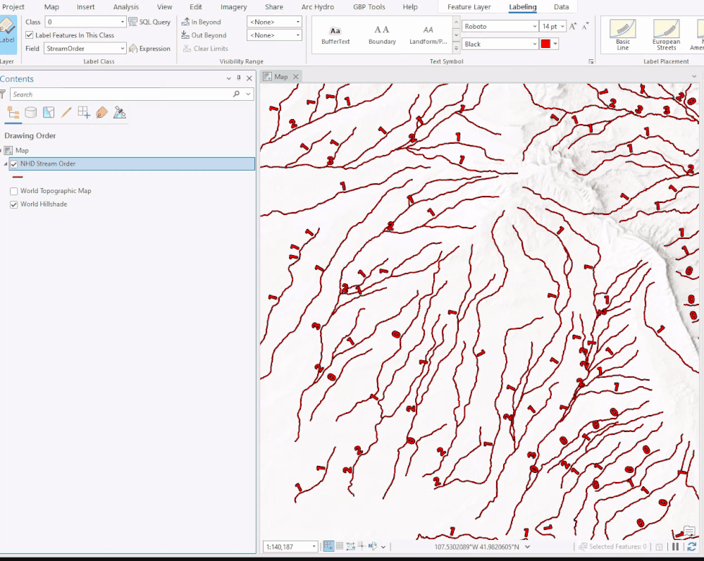

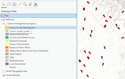

Wait, no, that doesn't make any sense. If I have drawing paused and I turn off a layer, its labels persist, even if you turn them off AND refresh. There's just no way that can be intentional behaviour-- what am I supposed to do with all these irrelevant labels now?
If anything, that kind of proves my counterpoint: when I personally try to Pause Drawing, it's generally as an "OH SHOOT NO I didn't mean to turn that on!", meaning that I'm hitting Pause as a last-ditch*(rarely successful, for reasons discussed already) effort to save myself several minutes until my project is ready to go again.**
Since the labels aren't ALSO getting removed with the layer, I can only assume that the Pause was thrown in as an "OH SHOOT" button-- stop everything, get rid of the problem, restart. (Side note: those labels also persist when I remove the layer entirely).***
