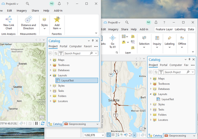

When you create a new Project you cannot immediately copy and paste a layout from a different Project without first creating a blank layout so that there is a Layouts folder in Catalog. It would be convenient to be able to right click and paste a copied layout without the extra step.

You can copy a layout from a project to another project which does not yet contain a layout (and therefore does not yet have the Layouts project container).  You do this by dragging the layout form the source project and drop it to the Catalog pane of the target project (or to its Catalog view Contents pane).  For example, in the following, I am dragging a layout from ProjectA to ProjectB, and as soon as the cursor reaches ProjetctB's Catalog pane, I get the cursor tip "+ Copy to Layouts":
I can then drop the layout anywhere in ProjectB's Catalog pane, and it will be copied and added to ProjectB:
Please let us know if this meets your needs.  Thank you for your feedback!

@NaicongLi I just tried it and drag and drop is not working between projects and copy and paste isn't either when the layout folder does not already exist. I am using 3.5.0 so if this is a bug I can get up with support and open a ticket.
NaicongLi
@cmathers - copy and paste won't work in this scenario, because  there is no existing Layouts project container yet in the target project for you to right click and say Paste.  This is a known limitation.  However drag and drop should work; in fact I just tried it in ArcGIS Pro 3.5 and confirmed that it is working there. I agree with you that in this case, working with the tech support and let them help you trouble shoot is a good idea.
