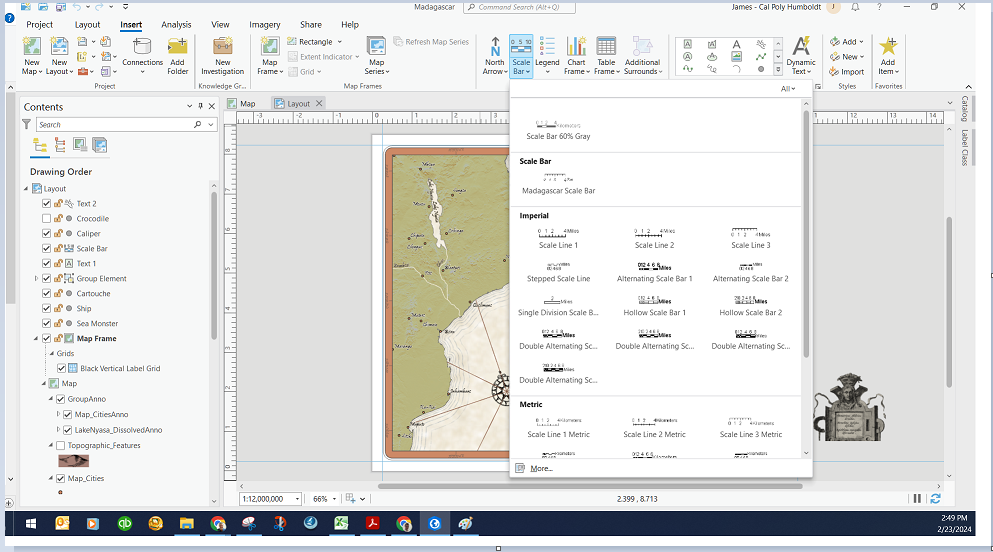

Here's the solution: Once you've got the scale bar the way you want it, save it as a style.
In Contents, right-click on your scale bar, go down the field and click on save as a style.
Then the box below pops up. Name your new scale. The next time you want to use it, go to insert scale bar and you will see it listed for your use. Hooray!

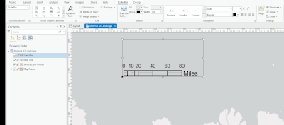

While not exactly what you requested, you can quickly change the color or font for all the text in a scale bar using the Text Symbol controls on the Scale Bar ribbon. Similarly you can use the Symbol controls to update all the symbols at once. So it's not a one-click solution, but you can accomplish what you want much faster using the ribbon. Does that help your scenario?
