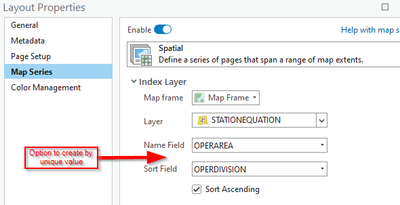

I am using a feature with thousands of records and would like to create a map series based on the unique attribute value within one field.
CompanyDivisionArea
ABCNorthGreat Lakes
ABCNorthNew England
ABCSouthGulf Coast
ABCSouthBayou
ABCWestRocky Mountain
ABCWestSalt Lake
For example, from this table, I would like to have the option to create a map series with 3 maps, one for each Division instead of 6 maps, 1 per feature.
