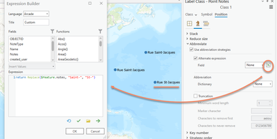

WendyHarrison
@GregoireS
The alternate expression will only abbreviate the word if it is needed to fit the label.
see the image below where the Replace function will swap out Saint- for St-
return Replace($feature.notes, "Saint-", "St-")
GregoireS
OK thanks for that precision and the code
