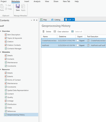

The Metadata editor in Pro 3.3 includes an interactive table that lists the Geoprocessing History/lineage stored in the dataset's metadata, which you can delete or export.
So you can choose to use the interactive experience, or for automation use the arcpy.metadata module. There isn't really a position for a geoprocessing tool given these alternatives.

@DrewFlater I wonder if it would be more accurate to say this idea was Implemented in 3.3, rather than Already Offered.
What's new in ArcGIS Pro 3.3 - Metadata
You can delete geoprocessing history items when you edit an item's metadata.
DrewFlater
The idea was marked as Already Offered based on the arcpy.metadata command to delete geoprocessing history, which has been available for several releases. The enhancement in Pro 3.3 supports a UI to accomplish the same goal through the metadata editor.
