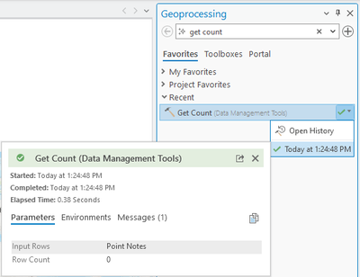

Also consider this: the Geoprocessing pane has a Recent section at the bottom with access to previously run tools, and the little menu will help you see the messages and reopen tools with parameter populated that were used previously. Internally I call this the Geoprocessing pane mini-history.

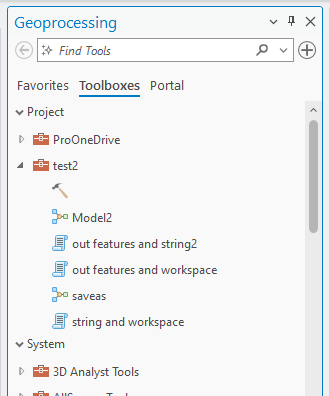

Also, rather than switching to the Catalog pane to access project toolboxes/tools, the same toolboxes are available in the Toolboxes tab of the Geoprocessing pane.
The Geoprocessing pane Recent (mini-history) and project Toolboxes were both added to keep you from needing to pane-switch as much, which would both help in the case you use the Back button since it would stay in the Geoprocessing pane.
