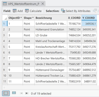

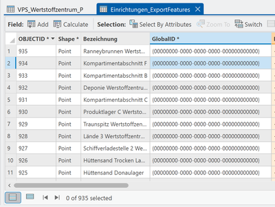

MarkusWall1
Hello,
I was able to reproduce it a few times last week, but it's not reproducible now.
What I figured out is, that when the option "preserver GlobalIDs" is set, the GlobalID of all importet objects is the same, but its {00000000-0000-0000-0000-000000000000}
I found an older screenshot from August, where I documented the problem with the same GlobalID after an import.
BR,
Markus
Origin FCOrigin FColder screenshot of appended dataolder screenshot of appended dataTarget FCTarget FC
KevinSaavedra
This is implemented in Pro 3.7. If the target dataset contains a Global ID field and the input data does not, running Append with the Preserve Global IDs environment set to True will automatically generate new Global ID values for inserted rows.
