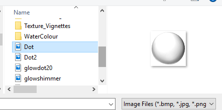

The possibilities using image markers within the ArcGIS Pro symbology dialog is awesome. However, if I add a tint to that image in the symbology dialog and export the map to PDF the resulting pdf document displays the original marker. This behaviour doesn't happen if exporting to other formats such as JPEG. In my mind this should be consistent. I'm trying to publish this as a map series (only available as PDF export.)
Original File:
Original image file used as an image marker with a tint.
ArcGIS Pro Symbology Dialog:
ArcGIS Pro symbology dialog for applying tint to image marker.
Result of PDF export:
PDF export of map with image markers with a tint applied.
JPEG export:
Jpeg sample
