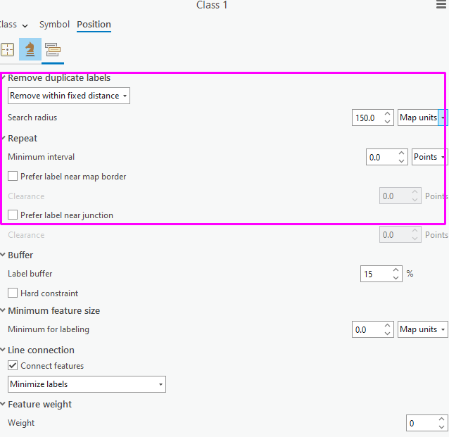

From pure labelling point of view, these options are what I often use so I don't have to wrangle data I want to keep fit for another purpose.
If you want to merge/sum the lengths per name in the label, for example, let me know when you've found an easy option 🙂

Yeah, I use those settings frequently, especially the "minimum feature size" setting. However, when my linear feature that is 100 miles is actually 160 individual features of .6 miles...

If the individual segments have the same name attribute and that name attribute is used for your label expression, turn on Line connection in the Maplex label settings (Position tab > Conflict resolution tab > Line connection). This will treat connecting lines with the same name as one single feature for labeling purposes.
AlfredBaldenweck
Oh, that's pretty sweet, and along the lines of what I was thinking.
It doesn't appear that there's a similar option for contiguous Polygons?
JesseWickizer
No, there's not a similar connection feature for polygons, but you can use the Remove duplicates functionality with polygons to limit how frequently the polygons get labeled.
