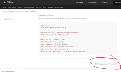

DuncanHornby
@Bud , sometime when a help page falls short on what it is explaining I have contacted ESRI, I assume their documentation team, through the link which I believe is at the bottom of every help page.
Just letting you and anyone else who reads this idea know that there is this method to contact ESRI on a specific page.
Bud
Thanks @DuncanHornby. I submitted feedback just now, as you suggested.
