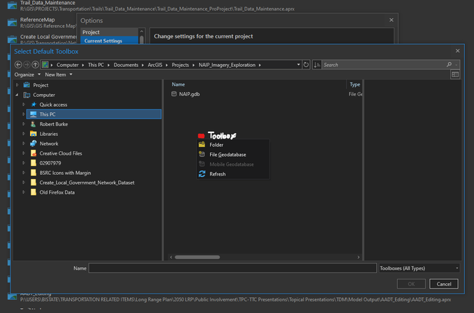

When setting the default home folder, geodatabase, and toolbox on a project, it's possible to create a new folder and geodatabase from the dialogs launched by the appropriate options, but not toolboxes.
Currently, it goes:
  1. cancel out
  2. save your options
  3. close the backstage
  4. find catalog view
  5. open catalog view
  6. navigate to the desired location
  7. create the toolbox
  8. close catalog view
  9. reopen the backstage
  10. reopen options
  11. launch the Select Default Toolbox box
  12. re-navigate to the new toolbox
  13. select it and try to save
  14. receive a 'The default toolbox does not exist' error (starting a support case on that now)
  15. cancel and close the application
  16. reopen the project
  17. reopen the backstage
  18. reopen options
  19. relaunch the Select Default Toolbox box
  20. re-navigate to the new toolbox
  21. select it and save.
Update: The error in step 14 cannot be resolved by restarting the application.
My proposed workflow:
  1. navigate to the desired location
  2. create the toolbox and save.

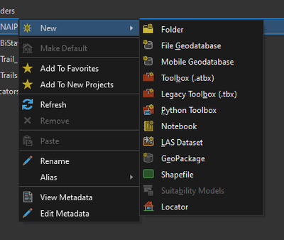

It would be even better if the same context menu available in folders in catalog view/pane were just implemented everywhere for consistency and ease of use.

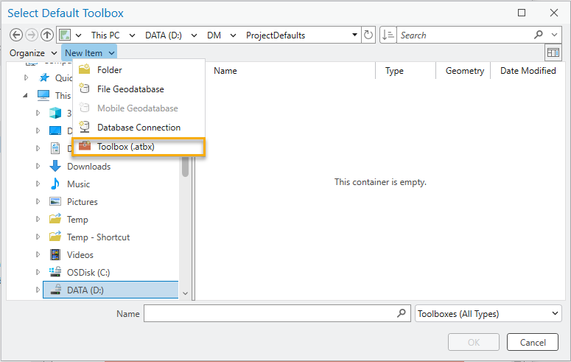

Hello @wayfaringrob ,
In ArcGIS Pro 3.5, "Toolbox (.atbx)" is added to the New Item drop down in browse dialogs, and it is enabled if the current location is a folder, for example:
When you click Toolbox (.atbx) in the drop down, a toolbox will be created in the current location, in rename mode (ready for you to modify its name).
Thank you very much for your feedback!
