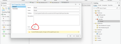

kntr
by
@GeeteshSingh Many thanks for your kind and prompt advice on this! I was able to change the icon for script tools, but this doesn't work for tools created with ModelBuilder.
Were you able to achieve this? Thanks. Cheers!

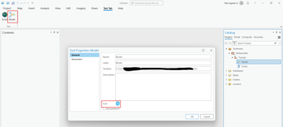

GeeteshSingh07
@kntr, yes for me both Model & Script tool works. Could you once check if you have added same model in ribbon? While customizing ribbon, model from different project is also suggested, so you might have added different model. We can try renaming this model..
