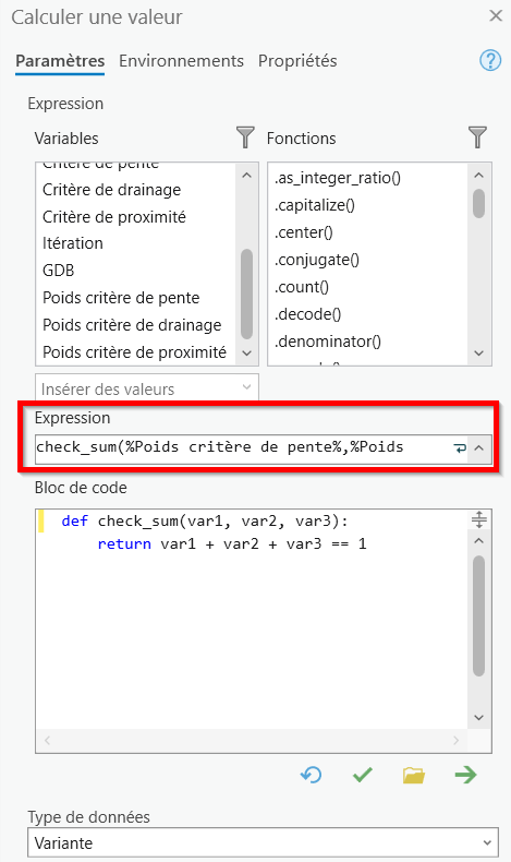

In the Field Calculator window:
As mentioned by @Anne-MarieDubois, it would help if we could vertically resize the Expression section to view/enter lengthy expressions.
Source: Expression Builder: Vertically resize sections
I'm aware that I can widen the entire window to view more of the Expression text. But at a certain point, I just want to make the expression parameter taller, not the window excessively wide.

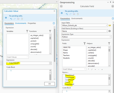

DrewFlater
The Calculate Field expression control already grows up to 5 lines to show longer expressions.
@Anne-MarieDubois  comment on the other issue is about Calculate Value which is a ModelBuilder utility tool. I can confirm that the Calc Value expression control does not exhibit the same growing behavior.

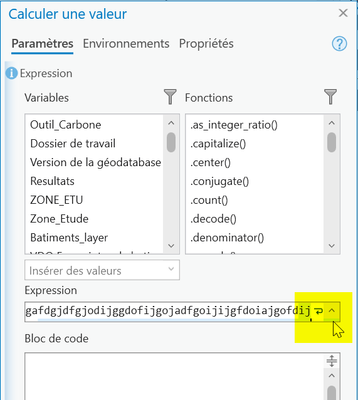

Anne-MarieDubois
Hi @DrewFlater ,
This doesn't seem to be an option for me.
No matter how long my expression is, I can't expand  the box.
Could this be linked to the latest patched not being installed?
