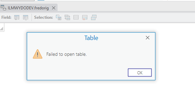

The privileges were applied to a feature dataset and therefore the items within it, but not to the related tables corresponding to those items. Note: The items in the dataset were the origin tables.
Users could see the feature dataset and the items within, but when they were added to the map, the "adding data" popup would appear, spin for a bit, then close before hitting the "finishing up" stage and actually adding to the map. Their records could also not be viewed in Catalog.
We could not figure out what the problem was until someone realized that the related standalone table did not have the same privileges applied.
No error message was given.
Updating the privileges for the related table fixed it.
