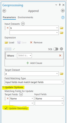

The workflow described can be accomplished starting in Pro 3.1, but not using the Calculate Field tool. The Append tool has a new geometry update mode and parameters to configure how the update should be made. This was covered in this newer Idea: https://community.esri.com/t5/arcgis-pro-ideas/gp-tool-to-batch-replace-geometries-from-one-fc-to/id...

But in Pro 3.1, it can be done using a different tool: the Append tool.
@DrewFlater Is that correct?

@Bud your summary is correct. ArcGIS in general has a hard limitation that any table can only have one Shape column. I talked to a few developers and our system would destabilize if we lifted a limitation that two Shape columns could be in one table as a result of a join or other process.
The Append/Upsert enhancement you explained is an easy solution for this problem, or you can write a few lines of Python code using a search and update cursor to read one feature geometry then write/calculate/update the geometry of another feature based on it.
