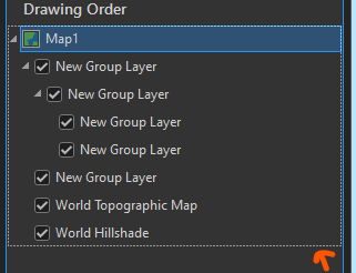

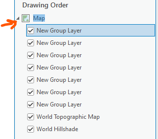

@RTPL_AU Now I am seeing something where if the Map is in focus, F2 will trigger rename on the map. If the group layer is in focus, F2 triggers rename on the group layer.
Example of the map being in focus:
What I've seen in 3.3.1 is that if the map is in focus, creating a new group layer, despite the group layer being selected, F2 triggers rename on the map.
This still sounds a bit different than what you're seeing since you say that nothing happens for you in certain scenarios. I interpret that to mean that F2 doesn't even trigger rename on the map.
