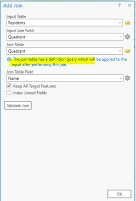

An informational tip will be added below the Join Table parameter in a future release, to indicate that the specified layer/table has a definition query which will be moved to the input layer when performing the join. This is such a special case and behavior we agree the information should be presented directly to the user, not behind a small warning icon or solely in the tool documentation. An editable definition query control will not be placed on the tool dialog, that is outside what we can do at this time.

ArcGIS Pro 3.2 has a parameter tip to indicate that the join table definition query will impact the join.

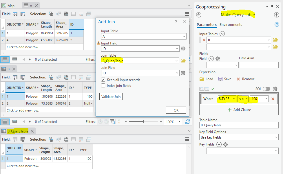

Just a heads up to anyone reading this:
An SQL Expression in Make Query Table does not produce a definition query in the resulting layer; the SQL Expression is hidden.  Consistent/visible SQL expressions and query definitions in layers
So, the Add Join tool will not warn the user about the SQL Expression, unlike if there was a definition query via Make Table View or Make Feature Layer.
But I suppose that's expected since the SQL Expression isn't a definition query, and this idea was specifically for definition queries.
