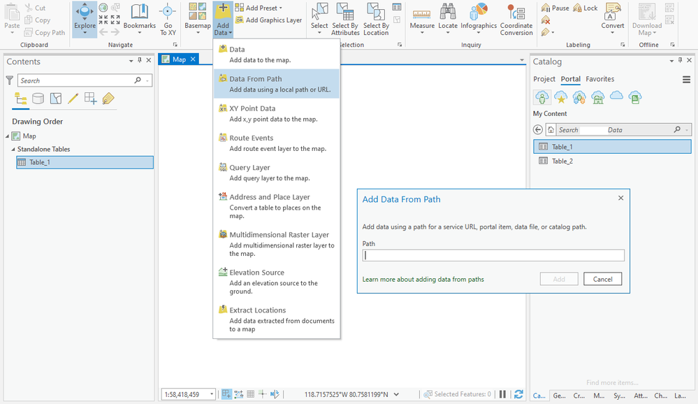

Using the Add Data From Path option from the Ribbon > Add Data menu:
I can add an entire hosted feature service to the map using the URL that I got from a feature layer's Properties > Source:
https://services7.arcgis.com/<removed>/arcgis/rest/services/New_File_Geodatabase_gdb/FeatureServer
But as far as I can tell, I can't add a specific table using a URL.
I tried adding /Table_1 to the end of the URL, but when I clicked Add in Add Data From Path, the dialog closed, but nothing happened; no layers were added.
Could Pro be enhanced so that we can add a specific table to the map using the Add Data From Path dialog?

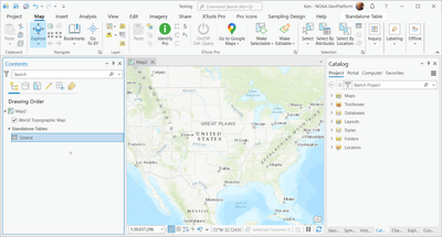

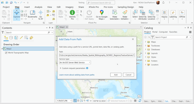

You can add in just the table using the URL. Your mistake is using the table name instead of its layer ID. For example, I have a service set up on AGOL with a spatial layer and several tables.
To add the Source table to ArcGIS Pro, I use id "1", not "Source"
and the table is added to my project

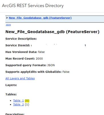

I can see that Table_1 is layer 0:
But when I add /0 to the URL, Pro still adds the entire Feature Service, not the specific table.
Any idea why it's doing that?
