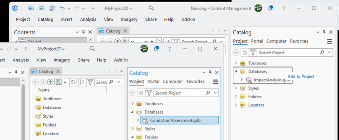

If I understand your suggestion correctly, you need to add some items (folders, databases, and so on) from one project to another project, for example, add the default geodatabase in project A to project B (so it appears under the Databases project container in project B).  If that's the case, ArcGIS Pro is already offering this functionality.
You can do this by dragging the default geodatabase in project A to the Databases container in project B. When your mouse hover over the Databases project container in project B, you will see a screen tip about adding the database you are dragging to project B:
When you drop (on the Databases container in project B), this geodatabase will be added to project B:
Similarly, if you want to add the default folder connection in project A to project B, drag that folder from project A to project B and drop it over the Folders project container.
Note that this functionality is not just for project default items.  You can drag-drop any items that can be project items from project A to B. For example, you can drag a map from project A to B even if project B doesn’t have any maps yet. Also, in project A you can browse to a database under a folder connection, and drag this database to project B and drop it onto the Databases container to add it to project B.

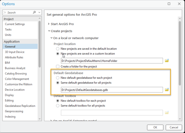

Also, if you prefer to have all your projects to include the SAME default folder and default geodatabase, then you can use the Options dialog to set it up so that any time you create a project, that new project would have the default folder and geodatabases as you specified.  In the Options dialog, go to the General tab, expand "Create projects", and expand "On a local and network computer", and set it up such as this:
