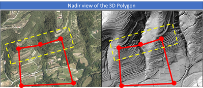

Simplify polygon feature with z-values taking into account the z-values.
Lets take the following example:

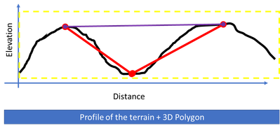

The exiting simplification tool will of course remove the point in the middle.
But a z aware tool will not.

ClaytonCrawford
Would treating the polygon boundary as a line and simplifying that in 3D work for you? If so, look to the Simplify3DLine GP tool.
https://pro.arcgis.com/en/pro-app/latest/tool-reference/3d-analyst/simplify-3d-line.htm
