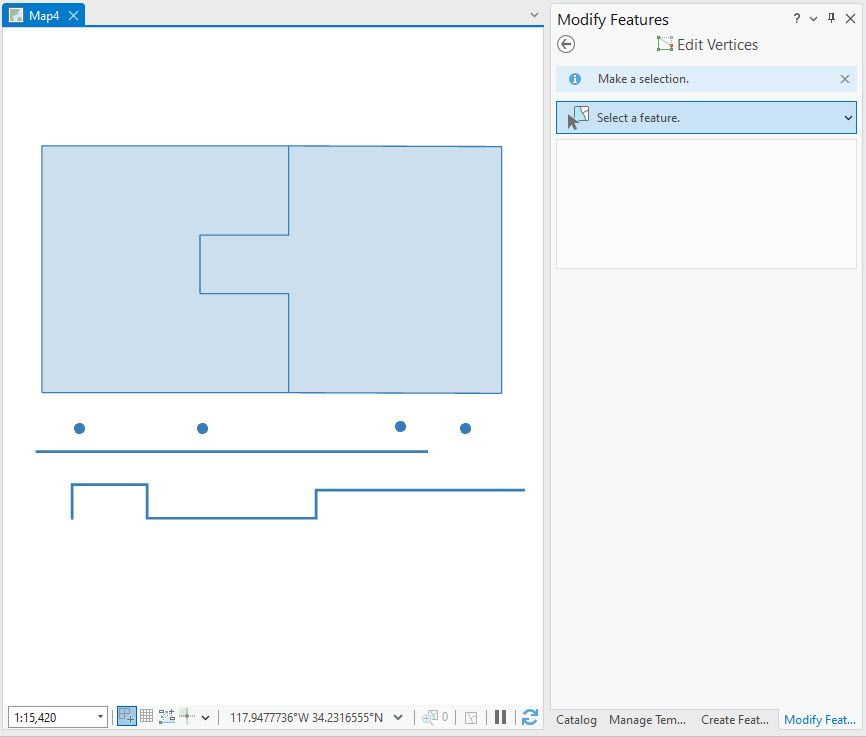

There are zero selected features on the map and you open the Edit Vertices tool from the Edit tools gallery or Modify Features pane.  On tool open, the active select tool is active and the tool name is ‘Select a feature’.  You interact with the map to select a valid feature. Once a single selectable and editable feature is selected, the Edit Vertices tool is active.
This is a key point; you do not need to use the core Select tool before choosing the edit tool or even once the tool is open.  Choose the editing tool, and then the pane will guide you through the rest, eliminating clicks between tabs and panes.
Alternatively, when the active select tool is active, a selection can be made via the attribute table or other methods and the Edit Vertices tool will activate.
Screenshot showing the  Edit Vertices tool without a selection.

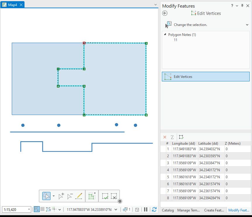

There is one valid selected feature on the map and you open the tool.  On tool open, the Edit Vertices tool is active. The active select tool name is ‘Change the selection’ indicating it can optionally be used to interactively redo the selection on the map or filter any external selections, e.g. table records were selected in the attribute table directly.
Screenshot showing the Edit Vertices tool with a valid selection.

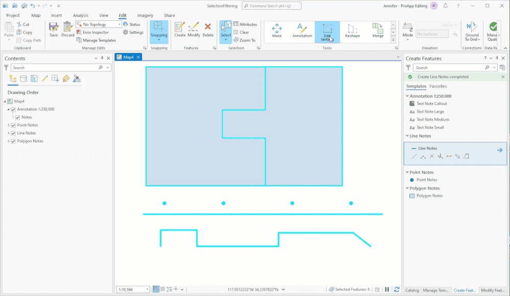

There is a mixture of valid and invalid features selected and you open the tool.  On tool open, the invalid selection is filtered (or cleared from the selection) and Edit Vertices tool will activate. Whenever a tool filters a selection, there will be a toast notification.  However, if after filtering there is more than one valid selected feature, the active select tool is active. EV_Toast.jpg
Screenshot showing the toast notification that appears in the top right corner
of the application when a selection is filtered.

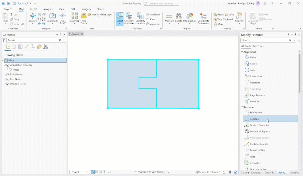

There are zero selected features on the map and you open the Reshape tool from the Edit tools gallery or Modify Features pane.  On tool open, the active select tool is active with the tool name ‘Select one or more lines or polygons’.  You interact with the map to select one or more editable line and/or polygon features.  Once selectable and editable features are selected, the Reshape tool is active.
Same as above, you do not need to use the core Select tool before choosing the edit tool or even once the tool is open. If you switch to the core Select tool, the edit tool will not automatically activate when there is a valid selection.

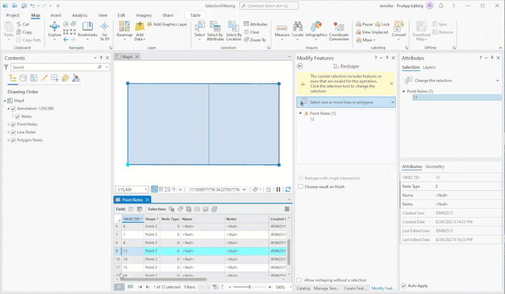

There is a mixture of valid and invalid features selected and the user opens the tool.  On tool open, the invalid selection is filtered (or cleared from the selection) and the Reshape tool will activate. Whenever a tool filters a selection, there will be a toast notification.
Selection filtering may be more apparent with Reshape than Edit Vertices since it will only select lines and polygons.
You can choose to reactivate the active select tool at any time while the tool is open to update the selection on the map or filter external selections, e.g. point features were added to the selection using Select by Location.
