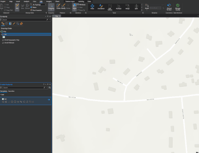

We periodically use the traverse tool to sketch in polygons, and it has always worked without issue in Pro. I'm not sure when exactly, but some time in the past month, the "Adjust" function of the tool seems to have broken. You can type in all the measurements, switch to the closure tab, hit adjust, and it appears to do so at first. But once you "finish" the traverse it reverts back to the unadjusted form. Has anyone experienced this issue before? It occurs on both local feature classes and data that is on network drives.
If I switch to ArcMap 10.8.2 and do the traverse there, it works fine. I've created a screen recording below to highlight the issue. You may have to click on it to see the full resolution.
Has anyone encountered this issue before?
